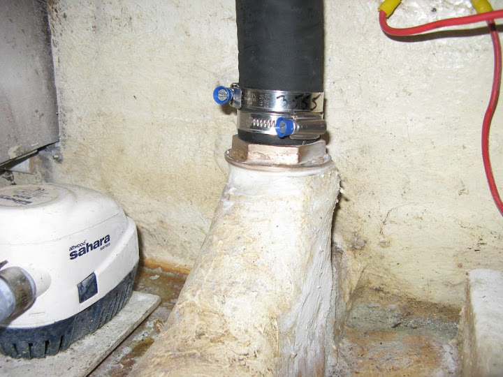

When you get all the glass off the neck of the through hull it should look like this, (which leaves plenty of room for two clamps):

Thanks for the Photo,s It will be a great help as I try to cut the fibreglass away and judge the distance down from the one clamp I can feel under the glass .
I purchased the Hose and ball from Catalina direct to make sure I had the correct parts . I will clean up and glass a flange to the hull that will allow a piece of pipe to fit in to give protection and as the water level is close to the bunk level will bring it 1 inch above ..

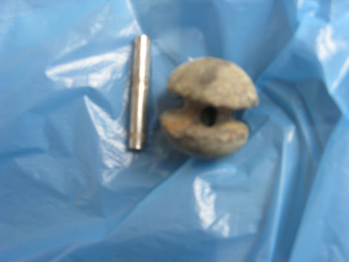

Frank , Thanks for the Photo,s My boat is now back in the water . The Fibreglass was cut away from the Cable hose and I found the ball cut thru and the SS shaft worn . The thru hull brass tube had corroded and the ball shaft had no support . The Shipwright then fitted a standard Flanged Thru hull fitting with the ball fitted . Thru hull had to be cut and M/C'ed . But is great with a flange on both sides of the hull and good epoxy bond .
Your photo was invaluable is showing what it should look like .

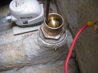

This is an attempt to post a photo of final repair So far so good
The Ball was Very warn Replacement was from Cat Direct ..Tube was 2inch too long

Don, excellent work, did you do that yourself?
Response Posted - 12/28/2010 :  17:42:32  Show Profile
Actually, those pictures are Boomeroo's.

Nice---looks better than the factory set up

Yes , The fact it has a flange under the hull and the screw down flange in the photo gave me a lot of confidence in the repair.
The Ball is CD's and the thru hull is a modified standard brass thru hull fitting
AND a big thanks to Don for fixing the photo's .
