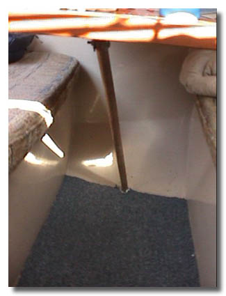

Here are two photos I would like to share. The first is
a table leg modification using 1" dowel 36 inches long. To replace
current leg, just drill out the pin that holds the old one on and use it or
another pin to fasten wooden leg to the existing table bracket. A closet rod
holder is attached to the cabin sole/floor to catch the leg. Makes all the
difference in the world as far as making the space under the table accessible/useable.
And no banging knees getting in and out of the dinette.

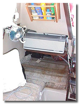

Second is the small AC unit that we made. It is water
cooled. Cost: $600.
