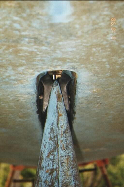

    KEEL BANG WHEN RAISED: RUBBER BUMPER
    To prevent the keel from banging against the side of the keel trunk when fully raised I made a rubber bumper which is bolted to the aft side of the keel, just below the lifting pennant and which fits snugly into the trunk when the keel is raised.
    The rubber bumper is a trailer bow guard (pictured on page 604 of West Marine's catalog, part number 417800) This is a 3" bow guard, the kind that looks like a Vee with a wide base. Price, $5.19. With a hacksaw I cut the guard into two pieces. Imagine cutting the V straight through so that the two "sides" of the V separate. The photo of the bumper show what it looks like after cutting and mounting.
    Lower the keel just enough to gain easy access to the area you're going to mount the bumper onto. See photos.
    Select a stainless steel bolt that will be long enough to pass through the rubber and the keel; drill a hole clear through. I found it helpful to clamp the bumper in place while drilling to ensure an accurate hole. Placing the bumper about three inches "below" the lifting pennant seemed to work just right.
    Bolt the bumper on, trim the end of the bolt so it isn't any wider than the rubber bumper. You're all set. Now, lifting the keel full up the rubber wedges into the trunk and prevents the keel from flopping side to side. Naturally, when the keel is down, some drag is produced by the bumper, but I've not noticed that it makes any difference.
