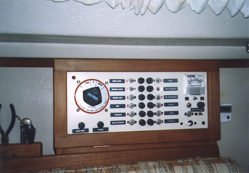

Magic Dragon - Electric Panel
This tip submitted by John Landers
The factory installed power panel was replaced with a considerably more sophisticated panel (I built it myself, if I can, anybody can), which was relocated to the starboard side at the aft end of the shelf. The new panel includes a selector switch for two #27 deep cycle batteries, individual switches for all electrical equipment, shore power switch and circuit breaker, a volt meter with selector switch, and selector switches for a hard mounted 10 amp battery charger and a 10 watt solar panel that is mounted on the stern rail.
