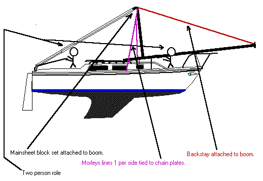

Note - Morley’s lines form a bridle from the end of the boom to each
chainplate. As the mast is lowered, the boom raises to an almost
vertical position (see picture). The purpose of the Morley’s lines
is to keep the boom from falling over to the port or starboard side
as it’s ascending. The lines should be tied so that when the mast
is down and resting on the bow pulpit, the Morley’s lines should be
taught, but not strained. In the mast up position, the lines will
be loose, as the mast is lowered they will become tighter. You’ll
need to experiment to get the correct length. For future use, mark
the lines once the correct length has been determined, or attach
snap shackles on the ends.
