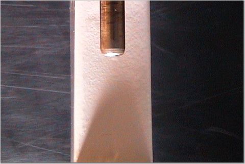

Rudder RepairFollowing the previous discussion, I removed the rudder at the end of October. My '85 rudder is a fiberglass encapsulated foam core, weighs maybe thirty pounds and floats enthusiastically. The fiberglass encapsulation was laid up in two halves by Catalina and then bonded to the foam core, somehow or another. The bond remains very good, however the seam had split all the way around creating a gap of between an 1/8" and a 1/4". (Unfortunately, I failed to take a "before" photo.) The following two photos were taken after the gap had been ground and cleaned out, slightly beveled and filled with epoxy.

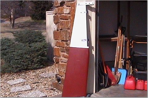

The through holes for the tiller and pintle hardware were also reamed out and filled with epoxy. After the fairing epoxy coats had dried, the hardware holes were redrilled and the entire rudder was sanded fair using an orbital hand sander with 60, 100, and then 220 grit wet sandpaper. Using sponge rollers, three coats of white epoxy topside paint were applied to the whole surface, and three coats of red anti-fouling paint were applied below the waterline.
